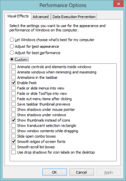

To late but that's okay I learned my lesson and now am on 8.1 and happy, Is there a way to now not disable but change the duration it takes when doing the minimize and maximize animations though? I have them off currently as you can like watch them do it since my resolution is so big and it takes a while.
On a side note: I found that and tried pretty all of that info but the bcd and most of my files were from ten so no repair tool could understand what my os was anymore I backed up what I needed off the ssd and started from scratch. Windows 8.1 does start up lightning fast compared to seven though(off to desktop in about 15 seconds).

Ok, glad you were able to 'sort it out' by moving up to Win8. I've been using Win8.1 for 3/4 of a year and find going back to Win7 (native Win8 Hyper-V machine) a bit clunky - Win8 is faster and MS has vastly improved the Windows Update process for devices - it works 99.9% of the time, whereas devices only worked 80% of the time in Win7 (mostly AMD and touchpad 'failures' requiring a rollback).
I only use the modern side of Win8.1 for the program menu, most apps are 'duplicates' of Desktop applications, and I find that the Desktop versions provide better depth.
As far as defining the animation or other visual effects - no, I don't know of any way to slow down or speed up animations. I have a minimalist configuration - only a few things that I like. No slides, no fades, no animations, no shadows .....

Yeah meant to change it not disable it, I'm back on 7 though as 8 was having some issues with my hardware and all things like memory speed was faster in 7 for some reason. 7 is all set and good now and this thread is officially over.
Thanks for all the help everyone.
