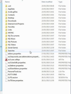

So the jpg shows exactly what I copied over - in the process of coping I was not allowed to copy over a few files they may have been dll files, I really did not pay much attention I just skipped through what I could not copy - but I started with 26 items in the "user" folder and I copied 26 items into the created folder
The "user" folder has everything in it that was there before I started

I have copied appdat local, locallaw, roaming before without too much trouble, yes, some files won't copy over. Ok, let's await the sevenforum gurus to enter and help you out.
