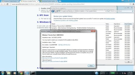

Win7 SP1 "successfully" installed but keeps showing in Windows Update
Hi guys,
I have been trying to install Win7 SP1 on my Lenovo SL410 laptop for the last couple of weeks now without success. :cry: The laptop would reboot and indicate configuring service pack, run till about 7-8% and restart after trying for a while. I have tried the steps stated on
Troubleshoot problems installing Service Pack 1 (SP1) for Windows 7 and Windows Server 2008 R2 - Windows Help
without much success. I have also downloaded the stand-alone and faced the same symptom. This is a fresh factory restore and I have not used any regcleaners on this laptop.
Some of the error codes encountered were 800705B4, 800F0826 with the latest being 80200001. This is what my update history looks like (as attached). Though it indicates that SP1 has been successfully installed, it is not listed under installed updates.

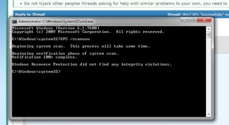

I ran CheckSUR and no errors were found in the log.
I ran SFC and no integrity violations were found.

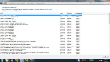

Are you talking about the new small Service Pack 1 update ?
Your windows already shows Service Pack 1 in system properties doesn`t it ?

Installation of SP1 failed again yesterday. Screenshot with error code 800705B4
SFC /scannow did not find any integrity violations.
CBS.zip as attached.
windowsupdate.log attached. The latest SP1 update which failed took place on 2015/03/24 - 13:45.
Thank you in advance for looking into this for me. Let me know if it gets too messy. I am prepared to just do another factory restore and start over, hoping to not run into this problem again.
