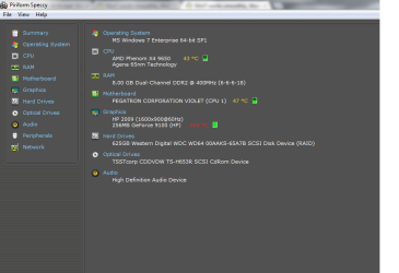

4. Speccy screenshot below
This has never come up in any other reports but it appears that my graphics card is 105 degrees Celsius....
I could very well see this being my problem but as far as I can tell my fans are all working properly so how would I resolve this?

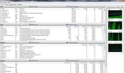

5. resmon screenshot below
6-7. my antivirus software is called super anti spyware free edition. we have it on all of the computers in our house and it works perfectly fine.

First, your GPU is running WAY too hot. Install GPUz to monitor GPU. Install this to stress it.
Second, SAS free, is NOT an anti virus program. You need to download Microsoft Security Essentials and do a full scan. Also, you need to download Malwarebytes Free and run a full scan on all of your accounts.

After further review your GeForce 9100 is more than likely the issue. I found thousands of posts about the very same issue by Googling "nvidia geforce 9100 overheating slowing computer". You should still do the other steps I have outlined for you, as they are necessary. But I am almost certain that your issue is the GeForce 9100. Is this an HP laptop or Desktop? What model?
