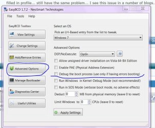

Have you tried the app. EasyBCD I found this screen. Might be worth a try. Good luck to you.
