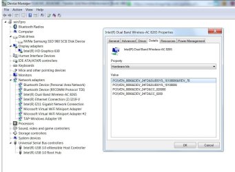

can you recreate the below on your computer and post a screenshot? Here's how
1) start>run>devmgmt.msc
2) left click on the triangles to the left of disk drives, display adapters, network adapters, and usb controllers, to expand them. (network adapters may already be expanded)
3) right click on the wireless adapter, select properties, then details, then hardware ids, then move the window so its aligned like mine is below so you can take a screenshot
here is a link on how to post a screenshot if you need it
Screenshots and Files - Upload and Post in Seven Forums
The problem is I can't see the wireless adapter. Do you still want a screen shot? edit here
Untitled — **************
