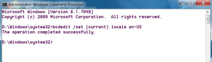

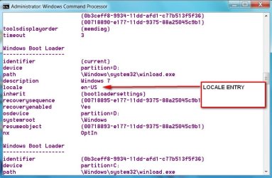

the boot screen to 7 says windows 7 recovered... and then has a boot screen for the vista loading bar.. although loading into 7.. kinda weird.. but still works
To get the Win 7 boot screen back to normal after a startup repair, reset the locale entry in bcd.
Open an elevated cmd prompt ( type cmd into start search box - when it pops up, rt click and Run as Admin )
Then type:
bcdedit /set {current} locale en-US {enter}
Use the locale that is correct for you, e.g. ru-RU, etc.
Hope it helps
