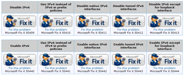

I've had the same intermittent connectivity problems with my Inspiron 1521 running Windows 7 64bit. I disabled IP6 using the utilities found here: How to disable certain Internet Protocol version 6 (IPv6) components in Windows Vista, Windows 7, and Windows Server 2008
Working so far!
This is a known IPv6 issue, but thanks for putting that MS link with all the Fix-It Solutions integrated and registry settings that goes with it. Very helpfull for those needed it!:)
