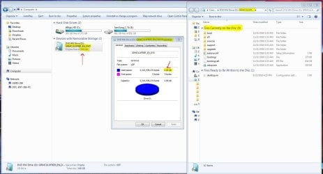

Here is snip for showing the size of the win7 Ultimate x64 w/ SP1 from my TechNet download.
