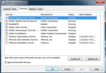

Can you post a screen capture of your services tab from MSCONFIG?
Also, try this useful little program that should isolate the item causing the long boot time - post an image of what it finds, but don't use it to make any changes - lets first see what it finds.

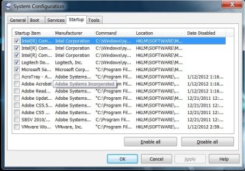

First off thank you for your response. Was really busy last week, but definitely wanna figure this out asap! Ok so I attached a screenshot of the msconfig services tab. The list itself was incredibly long, mostly containing microsoft services, so the screenshot i took is filtered for non-ms services. I figured the ms ones are standard and the non-ms ones would be the ones that may have changed? I could be wrong on that one though, but if u need the entire list i can always just attach a series of screenshots. And I had one question about soluto before installing it - I've read instances in which some users claimed the program was near impossible to uninstall because of all the registry entries it makes? Again I have no idea if thats true but wanted to check with you, as it could be unjustified. I just wanna make sure it's something I can easily remove all traces of once I'm done with it. Anyway, let me know what you think, Golden! And also let me know if u need the extra screenshots, etc. P.S. I included a screenshot of the startup tab on msconfig as well. Thanks so much for your time.

Uncheck everything except AV in msconfig>Startup and >Services after Hiding all MS Services. The rest are freeloaders on Startup, RAM, CPU and can spy on you. Enforce this vigorously.

AV=anti-virus. Run a free lightweight one like Microsoft Security Essentials or Avast with the Win7 Firewall for best performance.
Uncheck everything in msconfig>Startup and >Services (after hiding all MS Services) and keep them unchecked, except for your anti-virus.
You now have a clean boot.
