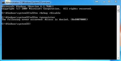

2nd command gives access denied error
tried the others anyway and gives

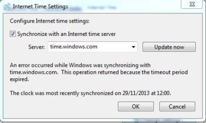

Ok so back with an update, unfortunately problem still persists but seems to have got worse as the date is now an issue

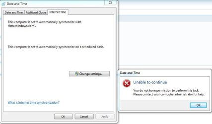

Clock is still going out by a few minutes here and there, I can manually change but if I go to internet time and click change settings I see this
I should add this is a single user machine with no passwords or anything
Also now with the correct date set and displaying in bottom corner of desktop when I go into a program (specifically my accounting software as this is work machine) and make an entry the date auto fills as 3 days in the past so I have to constantly change to correct date which is becoming rather annoying and then I have software spitting the dummy as it thinks I am trying to date things in the future which it doesn't like
Any ideas and thoughts would be appreciated

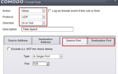

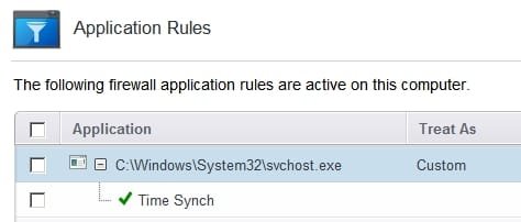

On my machine I've added a few tweaks that disable any unwanted communication with Microsoft and so have to use a different time server. I still had problems and after some research I've decided that my firewall is blocking NPT access on UDP port 123.
Created a new rule to allow the above and time synch works correctly.
EDIT: Forgot to mention that I had to use Process Hacker to get the PID for the correct svchost.exe process in order to create the firewall rule.
I have a feeling you did not run a elevated command prompt. Right click cmd run as administrator.
Both of those screenshots show it was run elevated.
