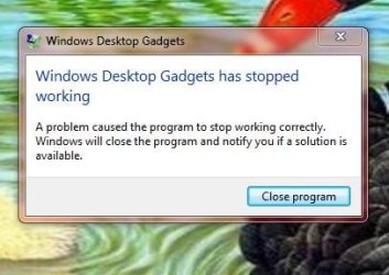

Windows 7 and Windows Desktop Gadgets have always been working fine lately until I installed my new Logitech E 2500 webcam. Every time when i start my computer an error will appear saying that Windows Desktop Gadgets have stopped working. I read the solutions in
http://www.sevenforums.com/customization/3744-gadgets-stopped-working.html
and
http://www.sevenforums.com/customization/12232-windows-gadget-has-stopped-working-error.html
but none of them fixed my problem. What else can I do to fix this?

I also tried restoring to default windows 7 gadgets, but when i press "Restore desktop gadgets installed with Windows" the error just pops up again.

hi i downloaded about 20 gadgets and installed them and all of them were open at the same time then i started to try them.suddenly the eror occured that the gadget stop working....
i think they had viruses
so my anti virus deleted them
after that when i right click and select gadgets
these two erors appear.
and when i try to restore default gadgets these erors occur again.
what can i do now to solve it?
can i uninstall the windows sidebar and reinstall it again?if yes can you give me the download link because i did'nt find it on internet.

Welcome to Seven Forums Malakeh. If you need help in the future, you will get more responses by starting a new thread, as this is an old thread. That said, try this:
Start> In search box type
turn windows features on or off
And press enter
Scroll down to Gadget Platform
Untick box next to gadget platform. Restart your PC. Repeat the steps and once again put the tick next to gadget platform. See if this corrects your problem.
If not, suggest you run the System File Checker
And see if that corrects it. If neither help, we can see if we can't help further. Either way, post back and let us know how it goes. A Guy

thank you very much
it worked and solved my problem
turning on & off the features didn't work so
i deleted the gadgets i installed and setting file in local-microsoft-windows sidebar
then i try them again
and it was fine

just go to my comp...,local disc c,uses,admi user,appdata,local,microsoft,windows sidebar,gadgets and erase all gadgets you downloaded:cool:
worked for me.....:cool:
