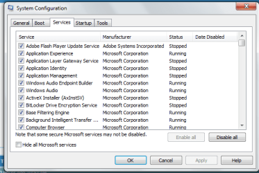

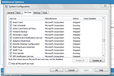

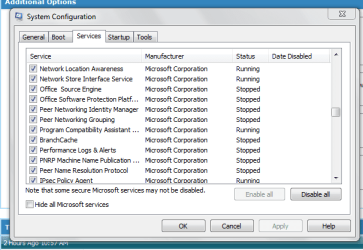

Is the drive empty? What are its contents, if no? You sure you don't have any virtual drive program running/autostarting at boot as a service?
Post your startup items and services listed in msconfig. Also post a screen of explorer window showing that drive. Ask if you need steps as how to do so.

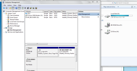

Listed in device manager and Disk management? If yes, then in disk management, right click the troublesome drive and select 'Change drive letter and paths', select the displayed letter (H in this care) and select remove.
What we're trying here is to see whether removing the drive letter removes this phantom drive or not.

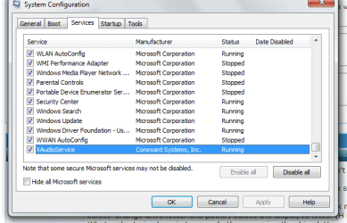

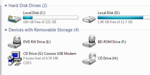

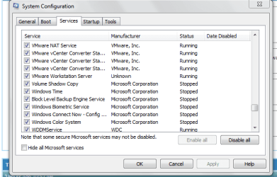

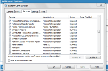

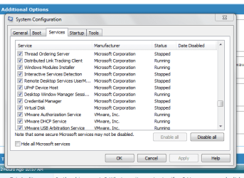

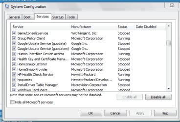

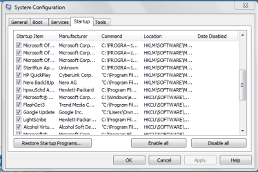

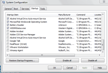

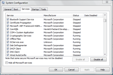

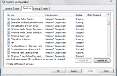

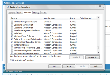

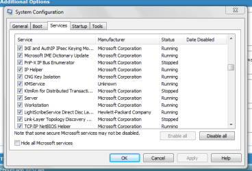

Here are the screenshots of my services, startup programs and of disk management and the explorer window. I also found something: In Regedit, i checked the HKEY_LOCAL_MACHINE\SYSTEM\MountedDevices and I found a binary key that was named H:\. I didn't delete it just yet because I didn't want to make the problem worse. So is it advisable to delete the key?

According to the screens, its G: and not H: .
If it is the H: you want to remove, then it might have been created by Alcohol. I see you've it in startup too. Check the Alcohol's settings to remove it.
If its the modem's driver's G: you want to remove, see if there's any reference to G: at HKEY_LOCAL_MACHINE\SYSTEM\MountedDevices.
