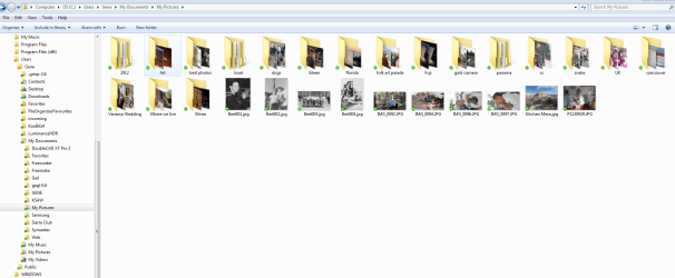

As you can see on the tree on the left, both folders are titled "My Pictures", one I got to from "Pictures" and one from "My Docutments\My Pictures". There is obviously more files shown in one. So I never know which way to get to "My Pictures" to see any particular file.

That doesn't look like a standard Win 7 setup for MyPictures. It looks like somehow you have a MyPictures folder in your MyDocuments and a separate MyPictures folder. Most strange. The standard setup would be to only have the separate MyPictures.

Well, those are two different locations is why they do not have the same contents.
C:\Users\Gene\My Documents\My Pictures
VS
C:\Users\Gene\My Pictures
Did you try and move your user folders to different locations?
Backup the contents in these folders to be safe, then try OPTION TWO in the tutorial below to restore the default location of your My Pictures folder.
http://www.sevenforums.com/tutorials/18583-user-folders-restore-default-location.html
problem fixed
Thanks Kado897. I synced both folders and deleted one, now all is well. I just never realised they were two different folders, since I never created one of them; don't know which. And it seemed that when I added a file, sometimes it would go to both, and sometimes just one. All's well as ends well.
