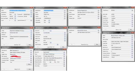

Here is what I've done for you, and I've also updated my profile for seven forums using the .exe provided and followed the instructions.
