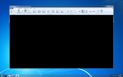

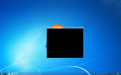

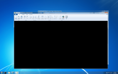

- I then went about installing WLE. This is where things went wrong. Everything installed correctly, but when opening any program from the pack I am met with some rendered components but mostly a black window.
Examples:
Has anyone ever seen something like this before?
I launched the VM under a windows host and in a non-seamless mode to confirm that it was not my Linux host or seamless mode which was causing the issue. The only resources I can find online are old microsoft.com posts which give a solution which do not apply to a new installation. Just in case, I tried it anyway, it was to check the windows file integrity, but no errors were found.
I would be grateful for any assistance anyone might provide. Thank you.
Examples:
