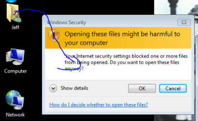

I am trying to open the my documents folder from my desktop and receive the Windows Security popup stating Your Internet security settings blocked one or more files from being opened. This just started to occur this morning.

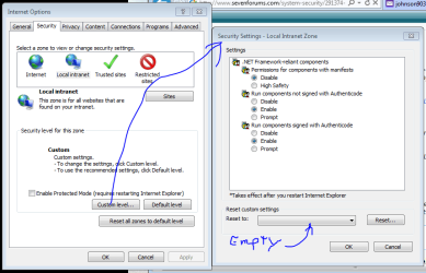

Here are the only options i have under Local Intranet:
The new piece of info i have discovered, is that I have two accounts on this laptop. One has no problem, the other userID will not launch anything. I created a new user id and it could not launch anything either.

johnson903,
Lots of entries missing from there...

I just had to post this since I spent the last 2.5 hours figuring this out on a work pc and every site I went to and every fix I tried nothing worked.
If there is any key under the below reg key that is not a number you'll get that error. I've reproduced it on 4 Win7 x64 Enterprise pc's and it broke every one of them. Hopefully someone struggling to find the answer like I was will stumble across this. I'm going to post it other places too to make it easier to find.
HKEY_LOCAL_MACHINE\SOFTWARE\Policies\Microsoft\Windows\CurrentVersion\Internet Settings\Zones
If you want to test, create a key like below and then try running appwiz.cpl from the command line.
HKEY_LOCAL_MACHINE\SOFTWARE\Policies\Microsoft\Windows\CurrentVersion\Internet Settings\Zones\a
