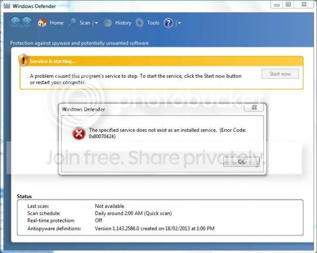

Hi everyone,
I am having a problem with my Windows 7 system on my Toshiba laptop. I discovered the problem while trying to download some software that requires the .NET framework 4.0. The framework software would not download.
While researching the error code that resulted from the .NET framework installation failure, I discovered that both Windows Update and Windows Defender are not working on my machine.
I have attempted to work through the instructions in the Windows Update Posting Instructions thread.

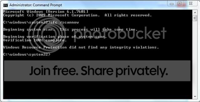

2) I have performed the SFC scan and get a message saying no integrity errors were found, as per the screen shot below:

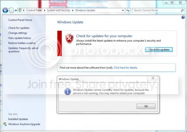

3)When I attempt to check for updates with Windows Update, I get the following error message saying the service is not running. I have tried restarting the computer as suggested but get the same result:

As a side note (I`m not sure if this is related, maybe it should be in its own thread) when I try to start Windows Defender, I get the following error message:
I have installed the latest Microsoft Security Essentials and I have update all of the device drivers on my computer using the Uniblue DriverScanner application so I should have the latest Intel drivers.
What should I do next to help solve this problem

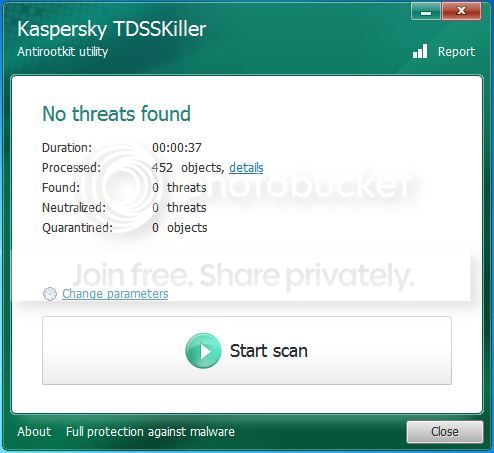

ZeroAccess is a particularly nasty beast - and can cause a LOT of problems even after 'removal'.
Please first run Anti-rootkit utility TDSSKiller and see what it has to say. Post the results.
There's no point in me repairing the currently known problems if you still have active malware present.

Hi Noel,
I ran the TDSS Killer program as requested, no threats were found:

I followed the above instructions and ran the ESET cleaner tool. It said that it did find Win64/Sirefef on my system and removed it.
Windows Update is now running. It must have been out of service for quite some time because there were 51 updates to install on my system.
I ran the FARBAR scan tool again and this is the log, it appears that all of the services are running except for Windows Defender.
