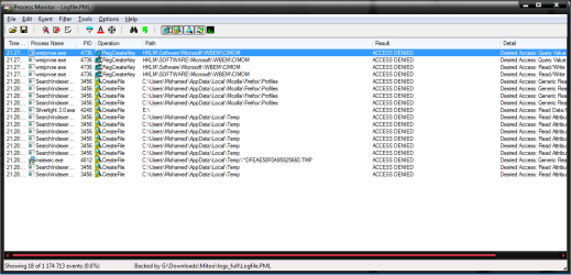

Poeple says error 2203 by Windows Installer relate to issue with permissions,possibly not only for Temp folder,there is way easy way to check it.
1.Download & run Process Monitor Process Monitor
2.Go to Windows Update and try install any hotfix for Office or Silverlight,when WU will return error ,save log in process monitor in *.PML format,pack it and upload on RapidShare: 1-CLICK Web hosting - Easy Filehosting
(log from PM will be to big to attache here)

Are you absolutely sure you correct checked permissions for TEMP folder in your accout? This means for C:\Users\Mohamed\AppData\Local\Temp.Both you (Mohamed) ,Administrators group and SYSTEM account must have full control for this folder and for other subfolders in C:\Users\Mohamed.It's clear from this log you have issue with permissions to TEMP folder in your profile:
Check it thoroughly again

ooooooooooh finally :D
thanks flavius :D but really i checked that yesterday & it was full control :D
anyway , everything is working smoothly right now :D
thanks again :D
I suspect any 3p program blocked you access to TEMP folder and thus you had false alert about not enough permissions to this folder,although permissions were OK. Anyway I glad to hear your problem has been resolved
