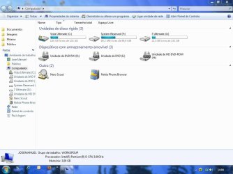

Hi,i'm having an problem with my 7 OS,because it wont startup correctly,yerstday i did an defrag on the system and let him shuttdown automaticly after this, but this morning i was unable to start the same, because the letter drive of 7 was moved from F to G but the system reserved stays on F like before where the OS was also F,i tried through system recovery but without sucess and many other possible solutions to startup but i got no results to this problem untill now,my question is,does somebody know how can i solve this issue,i'm using now vista,is possible if i change the letter drive from G to F will solve this or not?i let you an picture from the OS ob the computer panel,Thanks to all in advance.computer.jpg
i've tried to change the drive letter a few minutes ago and got no results because when i want to change the drive letter ,the letter F don't existes anymore because is located on SYSTEM RESERVED{F} i get more letters but not F,and i dont now why i cannot change to F.

HI,i did the defrag on 7,they are on separeted hdd,the most weird is that i try to start with 7,does everything fine t'ill STARTING WINDOWS and then goes down and ask to do an repair computer,but even so doesn't solve anything and says something about,hardware or software might be the problem!!!i don't know why this have changed the letter drive from F to G,because if i go to 7,vista is F and if i start vista goes the 7 to F,the 2 systems are primary partitions on diferent hdd's.

Hi,they change the letters drive ,if i go to vista {c} 7 is {f}and vice versa,but i didn't install anything before the defrag,that was defrag+optimize and did the shuttdown automatic, like did many times before without a problem,the weird is why is SYSTEM RESERVED {F} and now 7 ULTIMATE is {G},before this was SYSTEM RESERVED {F} and 7 ULTIMATE {F} and was running perfect but since this morning i fond it like i said,thanks.

Ummm, System Reserved and Ultimate (if that is the name of your primary 7 partition) can't both have been on F...that's not possible. Two partitions can't have the same drive letter at the same time.
