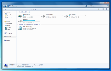

Hello dear forumers,
I am worrying about WinRE (G:) drive which suddenly appeared in Computer (Windows Explorer) window since today. It was never displayed there, and I knew its a system drive that is hidden by default.
Under the name and the used space bar, it says "3,35 GB free of 11,9 GB".
Is this somenhow normal? Any possibility for a fix? Because it was never viewable in Computer screen before.. and I think it shouldn't. I also wondering if the drive should have 11,9 GB or it should have less by default?

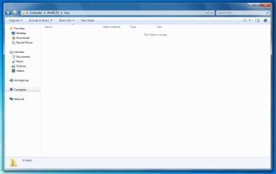

Please also post a screenshot of the folders contained within that partition.

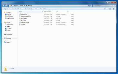

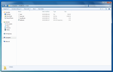

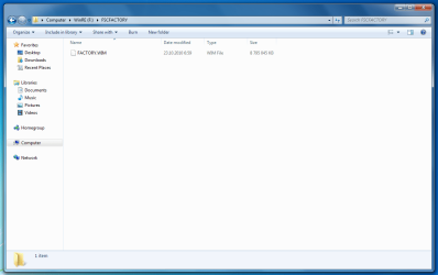

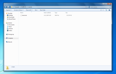

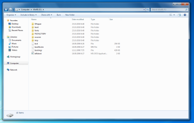

Hello, thanks for responding.
I have run a full antivirus scan that found no results, just before opening this thread. Per your request, I have used the snipping tool and made some screenshots.
Drive contents:

Could you please help with that? I am not sure how I go about this. Also, a few more screenshots..

Hello,
I have attached the Disk Management screenshot to this post, please forgive me for missing that out. And I won't mind you being away from the keyboard for the moment to spend your time with your dog. It's just great that you do that! I am not requesting speedy reply either, so I can wait. I am just wanting to know what this issue is caused by. (Particular the drive suddenly appearing out of nowhere)
To add on this, I have done nothing but log inn into the PC. I just came from vacation yesterday. I am very sure there is no malware found, since I am running Bullguard Antivirus and it has never failed for me. But I will do what you have suggested, using the offline Microsoft Defender... I report the results back.

The partition contents are posted at previous posts at this thread, if you have missed them out, check out:
http://www.sevenforums.com/1732937-post7.html
http://www.sevenforums.com/1732925-post6.html
