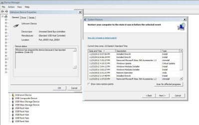

Yesterday about 10mins after my internet was fixed,my main laptop suddenly cut off my controller.I used it on this laptop all year with no issues till yesterday.
Every time I plugin the controller now it gets usb error code 43(not recognized).And it silently creates a restore point with "Installed Directx" every time I plug controller in:mad:
1-I uninstalled & reinstalled driver,nothing.
2-I tried a restore back to 7 days ago,nothing changed.
3-I ran directx,nothing yet again.
4-Tried every port with nothing else connected,nothing.
5-I tried unplugging everything,shutting down,holding down power to drain,& waiting 1-3hrs before turning laptop back on.Didn't work either.
All my games have been installed over a month ago,never had this issue.
At first I thought well maybe the controller took a dump.Plugged it in my ol gateway & it worked flawlessly.So negative on bad controller.
I tried all usb ports & get the 43 code still with controller.My flash & external drives read & work fine on all ports.So its definitely not bad usb ports either.
Can someone please help me get this working again without doing a complete clean reinstall over this one small issue?Everything else on the laptop is just fine.

Thanks.I'm going to mark this solved.It wouldn't work on any pc today.I resoldered a new usb cable & it still didn't read.
Ill just get a new one.I never liked how ps controllers feel.Sticking with xbox controllers
