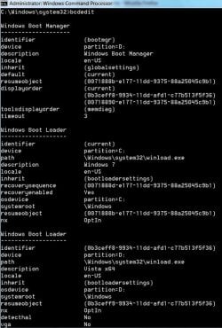

It would help to post screenshots of Disk Management, like this :
and bcdedit, like this:
Open an elevated command prompt ( in the Start search box type cmd, then right click on cmd (at top), and click on Run as administrator), type :
bcdedit {enter}
and post the contents of the cmd window.

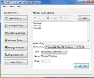

Easybcd will work fine in 7.
Try adding the entry for XP - select the partition the XP bootfiles are on - not necessarily the same as the partition as XP main o/s files are on.
In your case, it looks like XP bootfiles are on C.

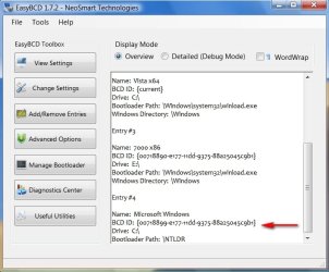

Ok - I followed those instructions, when I select "type" and windows nt/2k/xp/2k3 it grays out the drive below...leaving it at c:..
so I followed the rest of the tutorial, rebooted, got the menu, selected XP and got an error saying something about couldnt find boot.ini or something like that..then restarted the system and I was back at square one..
what can I do now? :o
