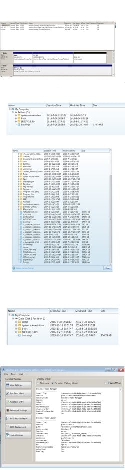

[FONT=&quot]Like a number of people, I used the Samsung data migration tool to transfer my Win7 operating system from one SSD to a larger one, and afterwords discovered that Windows would not start unless both drives were plugged in. I have spent the better part of 6 days trying every "Try this and see if it works!" solution I can find on the net, and none of them have worked for me. The original drive is an 840 EVO, the new one a 512 GB Samsung 951 NVME.[/FONT]
[FONT=&quot]A boot with only the 951 connected fails with a winload.exe missing error, and then booting from the install CD into Windows "Repair my Computer" results in the notice that Windows can't automatically fix the issue, and manual Startup Repair produces a no hard drive found message. From the command prompt, only the "Data" partition is recognized on the drive by Diskpart, which makes me think that the partition table on drive C may [FONT=&quot]an issue[/FONT].[/FONT]
[FONT=&quot]When booting with both drives attached, the Starting Windows screen appears for about 90 seconds before the log on screen comes up. The system behaves normally from that point on, with the exception that the restore function is inoperative –from both a backup file or a rescue disk. Obviously, the startup process spans both the original and the new drive, but I cannot sort things out so that the operating system [FONT=&quot]starts [/FONT]from the new 950 drive independently. After a week of frustration, I really, really hope [FONT=&quot]someone[/FONT] here can[FONT=&quot] diagnose[/FONT] what's [/FONT][FONT=&quot][FONT=&quot][/FONT][/FONT][FONT=&quot] going [FONT=&quot]wrong [/FONT]in the startup process and 2 explain how [FONT=&quot]to[/FONT] fix it.[/FONT]
[FONT=&quot]The first image below is the disk management panel, and the second is the File Explorer view of the 840 (original) drive files.[/FONT][FONT=&quot] The third image is the Explorer view of the C partition on the C: drive, and the last is a shot of the contents of the "Data" partition on that drive.

Looking at your Disk Management screen print in post #1,
Your Disk 1 D partition is the System, Active partition, so that's where the bootloader was used to start Windows.
Your Disk 0 Data (no letter) partition is Active, but it is not the System partition, so the bootloader there is not used now.

There are some information you gave that doesn't match the images you posted.
- Is Disk 0 the Sm951? You mentioned it's a 512 G but I can see 232 G on the image.
- Disk 1 label 840 is empty. Did you formatted it?
I've also notice that your drives are Legacy - MBR and some folders are from 2009 and it suggests that you have cloned your drive more than once.
Your actual system must have a lot of trash all over.
I'll suggest you to do a clean install.

Thank you all for your advice. You are correct, two or three years ago I cloned an original Windows 7 installation from a hard drive onto the Samsung 840. and it would have saved me an enormous amount of time if I had simply done a clean install on the 951 – I just didn't want to go through reinstalling all my applications again. At this point, it's almost a matter of pride not to give up making this work. And even if it doesn't, I've learned a hell of a lot about the boot process that I wouldn't otherwise have delved into. Nearly as fun as EMM386 and HIMEM.sys, so thank you.
