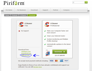

1.) Download CCleaner from the official site.
Download

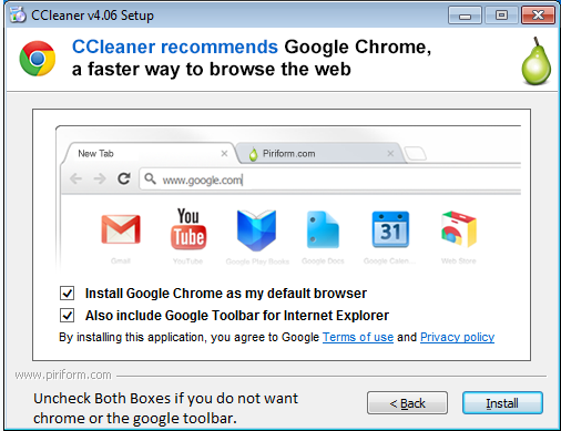

Once downloaded, run the installer as you would install any other application. This is just CCleaner you are installing, so do not accept to install chrome or any other suggested software.
You are offered chrome during the install, (if you already have it you won't be asked)
you can uncheck the boxes and choose not to install it. See image below:

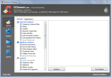

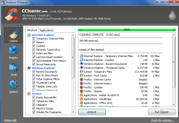

2.) Now that is done, Open ccleaner. You will see this screen:
In the screenshot, the options that can be safely checked for the average user are shown. You may stick with the default settings ccleaner has, or include what is in the screenshot. This is up to you.
Simple version: Open ccleaner, click run cleaner. More information is below.
Please note that Empty recycle bin is unchecked by default, as well as saved passwords are unchecked in internet explorer.
The reason is if these are checked the recycle bin will be emptied as well as all of your saved passwords on websites deleted. By default CCleaner will delete cookies.
*You can choose what cookies to keep under the options section in the guide.*
IF you want more information on cookies, see here: What is a cookie?
If you not want this to happen, make sure they are unchecked. As always, read before you hit clean. :)
   Tip
Make sure to close out of all programs and browsers before starting the cleaning
The application tab under cleaner provides other browsers to clean as well. Such as Firefox or Chrome. Antivirus software and other items might be included in the list.
Do not change anything from the default except other web browsers you have installed.
3.) Click Run Cleaner. CCleaner will confirm you want to clean up the system. Click ok. CCleaner will then run.
Once it completes you will see this screen below.
4.) CCleaner will give you a explanation on what was deleted, as well as how much space has been restored, and how much has been cleaned up. Just to let you know, if ccleaner is showing over 1GB or more removed, your system really needed a cleaning. :) After a restart you might even notice a performance boost.

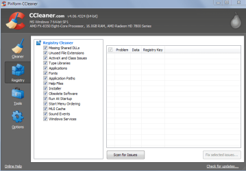

1.) CCleaner can clean the registry. While in Ccleaner click the registry tab. You will see a screen as shown below.

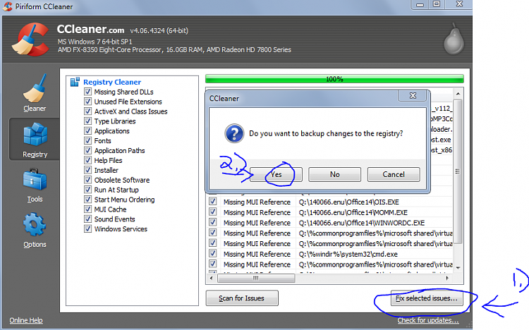

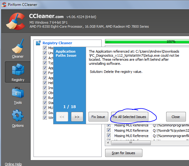

2.) Click scan for issues. Keep in mind that anything that shows up here is what CCleaner has determined to be a missing key. This does not mean you should delete everything you see in this list.
Select the items you want to delete, and click fix selected issues. CCleaner will ask you to backup your registry.
   Tip
I highly recommend you back up your registry before continuing.
3.) Click yes when CCleaner asks to save a backup, and then choose where to save the backup. Then click save. Choose fix all selected issues. Then click close.

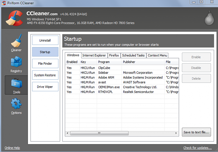

2.) Startup
This Will show you all the programs that your PC starts when it boots up. This is useful and easier to get to for some users compared to msconfig. CCleaner also allows you to delete entries, where msconfig only allows disabling them. This is a very useful function that many times I have recommended people use. There is also a save to text file option that will record/save a log showing all your startup entries. This is helpful when diagnosing slow boot up times.
There are other options as well within the startup tools option.
-The internet explorer tab will show all addons that are installed in internet explorer. (Same with firefox)
-The scheduled tasks tab lists all scheduled tasks in windows.
-The context menu Tab lists all the programs that have added themselves to the right click option.
This can be useful to clean up a long right click menu.
See this tutorial for more information on startup programs: http://www.sevenforums.com/tutorials/1401-startup-programs-change.html

Thanks for the tut. I'm not suggesting any changes. I'm just asking if you saw the image shown below when you installed the app?
>There are no toolbars or shady programs that come along for the ride. This is just CCleaner you are installing.
Since one can opt out, maybe you don't consider that coming along for the ride.
I downloaded the file from the link that you suggested.
W7 Pro SP1 64bit
i7
8GB
Intel HD Graphics
crappy SSD
Strange wasnt offered that and I dont have chrome. I will add it to the tutorial.
I never have seen that before when downloading and installing ccleaner. Weird.
Tried again in VM. It offered it in xp but not vista or 7 or 8. Chrome is more secure so I can see it being offered especially on xp.
I don't know?
Ah. Found some info online. Once you say no to google once, it remembers your setting. I have avast installed and it offers to install chrome. I chose no. Google remembers this and doesn't ask you after you deny them the first time from what I understand.
