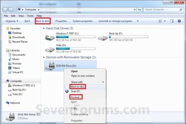

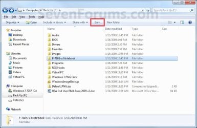

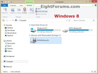

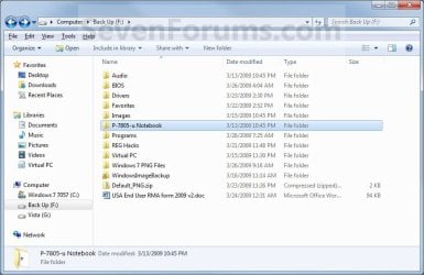

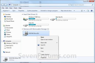

EXAMPLE: Built-in CD and DVD Burning Features Enabled and Disabled
NOTE: Left screenshots below are enabled, and right screenshots are disabled.
