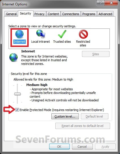

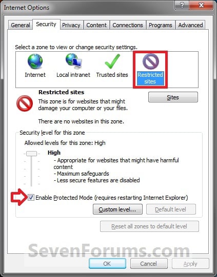

    3. In the Security tab, select the zone that you want to turn protected mode on or off in. (see screenshots below)
    Internet Explorer Protected Mode - Turn On or Off-internet_zone.jpgInternet Explorer Protected Mode - Turn On or Off-local_intranet_zone.jpg
    Internet Explorer Protected Mode - Turn On or Off-trusted_sites_zone.jpgInternet Explorer Protected Mode - Turn On or Off-restricted_sites_zone.jpg
    4. To Turn On Protected Mode in Internet Explorer
    A) Check the Enable Protected Mode box, and click/tap on Apply. (see screenshots above)
    B) Go to step 6.
    5. To Turn Off Protected Mode in Internet Explorer
    A) Uncheck the Enable Protected Mode box, and click/tap on Apply. (see screenshots above)
    6. Repeats steps 3 to 5 if you want to turn protected mode on or off for any other zone.
    7. When done, click/tap on OK. (see screenshots above)
