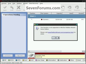

The free Partition Wizard no longer supports converting a Dynamic to a Basic disk.
click to enlarge
Which again is why I have the change type ID option. It is a current Partition Wizard option. Details in the post link I provided.

You guys really threw lots of info at me on the last posts. So it there a consensus that the free Partition Magic will not do the job and allow me to use the bootable CD to convert Dynamic back to Basic?
If I understand correctly, the Tutorial on how to Convert a Dynamic Disk to a Basic Disk is destructive so I'd lose everything on the HD?

Yes you can convert dynamic to basic using the current Partition Wizard using the steps I outlined. (It's not original see the references).
The tutorial is not destructive if option 3 is followed. But like any technique it can fail and a backup in case of failure is essential.

I concur that converting is preferable which is why I first recommended it. However now that we learn the PW free edition doesn't contain Conversion Dynamic>Basic any longer, I am not aware of any method that safely converts without risk of data destruction.
Michael: does the PW free edition support the method you outline in the Tutorial's comments? Have you tested this in the same scenario without data loss? Just asking.
I cannot personally verify it works but people report it does work by doing the changes with a Hex editor. Any way will have a risk and the OP needs to have full backups.
If you look at the OP's screenshot from diskmanagement and BFK's from PW. PW only shows the whole of the dynamic disk not the components. I now feel the changes will require a Hex editor. It's easy for me to say it's easy, but I think it may freak out the uninitiated.
Now the good news courtesy of Jonathan King who gave the following link in the tutorial thread. It's an older version of PW which should do the conversion automatically.
Jonathan King link to V4.2
1) download the zip and extract
2) run the installer
3) start the application
4) select the disk and go to "Disk" drop down menu
5) select "convert dynamic disk to basic"
6) apply
It should be run from the desktop. Again do at your own risk.
