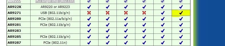

The other driver that you also need installed can be found here; ASUSTeK Computer Inc. -Support- Drivers and Download P6T Deluxe
You are talking about two devices here and they are independant of each other
Which items from there do you recommend I download from that list. Sorry for being a bother with this, I really appreciate the trouble you're going through for me.
It depends how you connect to the internet The netgear device is Wlan and you need the Atheros driver for it to work.
You mentioned ethernet which I presume is a wired connection if this is the case you will need the Marvell and maybe the Realtek drivers.

I tried downloading the Marvell drivers earlier but still had no luck (I tried ICS as a temporary solution to no avail). For some reason I can't get the Atheros drivers installed properly either. I have no idea where I'm going wrong there. x.x
Asus P6t Deluxe
HD 5970
Just confirm that this is the driverlink that you clicked to download the Atheros drivers
and that this is the driver you are trying to install

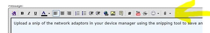

Upload a snip of the network adaptors in your device manager using the snipping tool to save an image and the paperclip to attach it to your post
here is a copy of mine
I also have the drivers you linked. Downloaded the other one just in case. Just unsure if I'm doing the installation process. Correctly. What you see displayed comes up whenever I plug in the adapter but I cannot finish installing Netgear's latest software due to the driver issue mentioned in my first post. Sorry again for being such a bother. x.x
