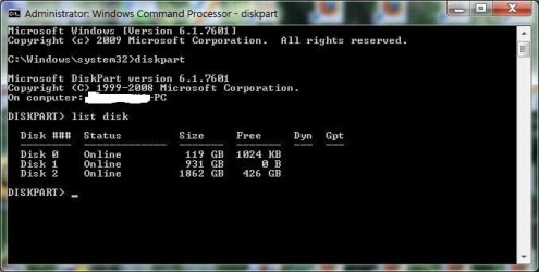

Prepare the SSD – You first have to initialize the SSD to create the MBR. You can do that with Disk Management or with this program (which you will need later anyhow).
Then you need to align the SSD and define an active partition on it. You use an elevated Command Prompt with the following commands:
Diskpart
List disk
Select disk n (where n is the number that was given for your SSD in List disk)
Clean
Create partition primary align=1024
Format fs=ntfs quick
Active (assuming you want to install an OS)
Exit

If you want to verify that the alignment is correct, you use these commands:
Diskpart
List disk
Select disk n
List partition
You should see a result like this:
Partition ### Type Size Offset
Partition 1 Primary 59 GB
1024 KB - but 64KB or any number divisible by 4 is also good. The offset has to be divisible by 4.

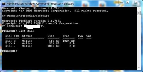

in the middle of the tutorial when I get to the disk list step it says all my drives have 0B of free space is there a way to fix this?

Zero bytes is only for drives that have no media or those that are formatted in Fat32 like my drive #7 which is a USB stick.

all my drives are NTFS and showed online including my boot drive disk1 and my external storage drive disk 2

That is strange indeed. No idea what could be the cause of that.
@ Lunok & whs
Might a chkdsk help shed some light on this mystery?
It certainly would not hurt. But I would think that cmd gets this info from the MFT the same as Disk Management or Partition Wizard that you show behind the cmd window. So chances that chkdsk can fix it are slim.
I may be missing something in the question but your diskpart/List Disk screen shot looks fine. The "free" entry refers to unallocated space not unused space.
This is normally 0B or a small number. If I take a 2TB HDD and unallocate 426MB then "free" will show 426MB when it was 0B. Note disk 2 here:
