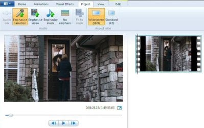

But when the 16:9 video shows as 4:3 on the storyboard, then you have to change the aspect ratio in the Project tab.

The screen dump shows the Preview Pane correctly filled with a 16:9 video frame, without distortion or black bands.
The video clip frame in the storyboard panel show that WLMM has laterally squashed the 16:9 data to 4:3 and inserted black bands to refill the 16:9 frame.
It should not do this. It seems to have lost the aspect ratio control when it prepares the storyboard panel contents.
I really think this is a bug, and if I knew how to log it with the MS developer I would do so!
