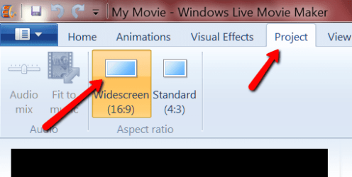

But when the 16:9 video shows as 4:3 on the storyboard, then you have to change the aspect ratio in the Project tab.

Changing the aspect ratio in the Project tab does not get rid of the black bands in the presentation pane video clip which were incorrectly put there by WLMM.
This is a bug!
