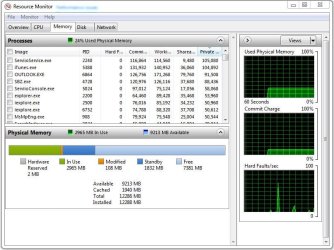

hi,
have been having trouble with my ram for past couple of months, once every couple of days or weeks I will have 8gb usable but the majority of the time it only gives me 3.98 of 8gb which can happen without me changing any settings.
So far I have run windows memory diagnostic, memtest x86 with no errors, updated my bios to the most current and unchecked the max ram box in msconfig and made changes permenent, I'm starting to think that the socket could be intermittently faulty but that wouldn't make sense as every boot the ram is detected as 8gb but only reads 4096, I have also had a look at the pins on the motherboard and they look straight and I have not messed any installs up. Im fairly stuck so any help would be appreciated. I will detail the full spec of the system below.

RESOURSE MONITOR ATTACHED.
Have run memtest x86 with no reported errors

Well first thing that jumps out at me is that you have WAY too much (nearly 4gig) hardware memory reserved.
First, check your MSCONFIG settings by typing "msconfig" (no quotes) in the search bar and making sure the Maximum memory box is not ticked. See this post - http://www.sevenforums.com/performa...al-memory-but-1-74-gb-usable.html#post1649304
You can also check this post for clarification as well - http://www.sevenforums.com/performa...-memory-but-1-74-gb-usable-4.html#post1650067
If that doesn't work check to see if your motherboard has an integrated GPU. If so disable it in the BIOS.
Let me know.

Bottom line is you need to figure out what is eating so much of your RAM as I said before, you have way too much hardware reserved RAM. It should never be that high.

Any time I have seen people with hardware that high it not Windows 7 causing the problem. My hardware is 9MB.
Normally it's the ram is not installed properly or mismatched. Not setting the ram properly in the bios has also cause the problem. I have on one of my computers had a seating problem cause this problem. I discovered this by using my palm heal and smacking the corner of the case while watching Resource Monitor. Reseated the ram and it was fixed.

Yes I do have two sticks of pny, just as an update though, as something that I haven't tried I have enabled the multi igfx monitor in the bios and after three resetsi am still seeing the full 8gb, with any luck that was the mystery setting but im not sure, what do you guys think?

Set your bios to default. No over clock of anything.
Then give us another Resource Monitor picture of your memory.

current state
