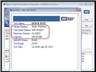

It is a false positive. It reads 0 GB - does not read even one single sector - and gives a PASS. If the drive is recognised correctly it should indicate the Model Number, Unit Serial Number, Firmware Number, and Capacity as in the screenshot below.
It is definitely the failure of the PCB in the drive. Look at the PCB very carefully. There should be some sort of part identification number in it. ( It could be in the invisible backside also).You should get exactly the same part number board if you want to replace it. As I said it may well be impossible to get the same part Number board especially if it is a many years old drive. Manufacturers change the chips and/or firmware in the board often. So the board in the same model current drive may or may not work. Lots of uncertainities. The data recovery job is best left to WD Data Recovery Partners, who as I said may have the board in their jig, or even rejig one with the same components, flash the same firmware and recover the data. I do not know exactly what they do but they can do it. If you want to get your data , cost no matter that is the only way to go. You can contact the data recovery partners in your zone and discuss. Telephonic consultation is free. They may also give you a quote.
