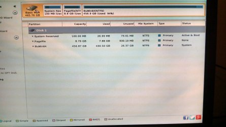

Can you post a screenshot of the final drive layout from bootable Partition Wizard free? Bootable Partition Manger | MiniTool Partition Wizard Bootable Edition. Make sure all partitions and details are visible.
Deleted the System Reserve partition and let 3 x Startup Repair rebuild the partition.
You have to mark active the Windows partition, then run the startup repairs. Can be done with DiskPart or Partition Wizard.
Windows 7 Ultimate x64 SP1AMD Phenom 2 1090T2x8GB Kingston HyperX Fury Black 1600Mhz Unga...MSI GTX 970 Gaming 4G
AMD Phenom 2 1090T
Gigabyte GA-890FXA-UD5
3xAcer GD245HQ
HighPower 1000W
Cooler Master HAF 932
Noctua NH-D14
Logitech G19
Logitech G500
IE 11 - Firefox - Chrome
With or without deleting the System Reserved partition? Deleted the System Reserved partition, marked Windows partition as Active and ran Startup Repair. It didn't rebuild the System Reserved Partition. I've seen it done several ways in the forums.
Thanks for your response. System Reserved is marked Active.

systemroot -----------------------------------------\Windows
resumeobject -------------------------------------{23512ef6-c62b-11e0-a274-99f9dbd9b8b1}
nx -------------------------------------------------------OptIn
Device and Osdevice show up as unknown.
Now that the System partition had a drive letter assigned, BCDEdit could point to the correct partition.
Referenced for the appropriate commands - Steps 4, 5, 6, and 7:
https://support.symantec.com/en_US/article.TECH160475.html
Previously BCDEdit would give an error message. Now "The operation completed successfully.) :D
bcdedit /set {DEFAULT} device partition=c:
(press enter)
bcdedit /set {DEFAULT} osdevice partition=c:
(press enter)
bcdedit /set {BOOTMGR} device partition=c:
(press enter)
7. Reboot the system after removing the OS disk.
Now after running BCDEdit:
Windows Boot Manager
Device -------------- Partition=C:
Windows Boot Loader
osdevice ------------ Partition=C:
Now it will boot!
Let me know if any of the terminology needs correcting.

Good one :) Startup repair should have done this for you. I wonder now, did you run startup repair 3 times when you first set system active?
Also, out of curiosity, why a pagefile partition?
That's what I thought! That's the way I read it. Then I found a thread about using BCDEdit to repair the issue. Still wasn't able to access the System partition because there was no drive letter.
I tried the 3 x startup repair a minimum of 6 times (I kept notes) after making sure the partition was active through diskpart and MiniTool Partition Wizard. Like you suggested, I also tried 2 times - deleting the System Reserved partition, marking Windows partition as active and ran 3 x Startup repair. The error message changed to 0xc000000f after that, but still the same issue. Even installed Windows 7 on another drive and cloned the system partition to it.
Around the time I did my last backup, the computer took a very long time to boot up. Probably sat there 5 minutes with no disk activity when the desktop appeared. The drive was probably failing then and I figured my Windows 7 partition backup was corrupt.
I've probably cloned the original backup 10 times so I could experiment without destroying everything.
I check the EULA on the W7 disk and it had SP1 installed.
I'm working off a secondary hard drive right now. I put the primary hard drives page file on the secondary hard drive. Left just enough space for a memory dump. 300 mb. Probably a throwback to XP days. I set this up over 4 years ago when I installed W7. Back then, every article I read on the subject had a different suggestion for the page file size.
What's your opinion of this setup? I have 4gb of ram.

I saved this page for future reference. One more method doesn't hurt ;)
With respect to pagefile, I would say; move it to C and let Windows manage it (delete this partition and add to C with Partition Wizard free). If you had another drive, performance would have been improved if you had it on the secondary. Or perhaps some on both drives.

This will be my setup:
Primary:
System Reserved
Windows
Secondary:
System Reserved
Pagefile
Windows.
I ran across a HotFix where you can eliminate the pagefile on the primary hard drive and still create a Memory Dump:
https://support.microsoft.com/en-us/kb/2716542
I set it to 300mb on the System partition previously and 2 times the RAM size on the secondary drive. Never found a consensus on the correct size for W7.
Another thing I noticed, the Restore Points were turned off for the backup drive and it had them turned on for the old drive (marked as missing under Protection Settings).
