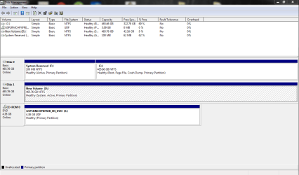

Hi , new user here. Currently i'm having some problems with my window 7 home premium, any ideas how to switch the system partition status back to my system reserved? I tried to set inactive with diskpart for my backup Drive D: but it will cause BOOTMGR IS MISSING.
Another problem is that , after a certain period when the laptop is off, when i power on the laptop, it will cause errors such as oxc000000f.Apprently my drive letter will randomly swap around , for example My window drive C: will swap with my backup/system reserved letter, even switching back to the correct letter and startup repair it , the end result is no os files found on disk. a temporary fixed is to delete the drive,install window 7 then system image restore back again. Any help for this?

You should only have one HD/SSD drive connected when you install Windows, the drive where you are installing Windows.
My guess is you had two drives connected when you installed Windows and that caused the issues.
To fix your current install you can try this:
- Disconnect the backup drive
- Run Startup Repair (run it 3 times with a reboot after each Repair)
Here's some tutorials about Startup Repair:
http://www.sevenforums.com/tutorials/681-startup-repair.html
http://www.sevenforums.com/tutorials/105541-startup-repair-run-3-separate-times.html
See if Windows will now boot successfully with the backup drive disconnected.
OR, if you're up for another re-install, here's a tutorial for a clean install.
http://www.sevenforums.com/tutorials/219487-clean-reinstall-factory-oem-windows-7-a.html
If you don't want to re-install, read through it and see how it compares to how you installed Windows.
When everything is working correctly with only the one HD connected, reconnect HD two (Backup drive) and remove the active flag

As David says you should be recovering using the image from the application's boot disk. If it's Win7 backup imaging then follow this: System Image Recovery.
As to how to move the System flag to System Reserved, Is this another internal hard drive? See if you can disable the storage drive in BIOS setup before running Startup Repair - Run 3 Separate Times.
If unable to disable or disconnect the storage drive - don't risk ruining your laptop if you're not confident of disassembly - then I would download Partition Wizard CD, burn to CD using Windows Image Burner, boot it to rightclick Storage drive, select Modify>Set to Inactive, OK. Apply step. How to Set Active/Inactive partition -Partition Wizard Video Help.
Next rightclick D to Modify>Set to Logical, OK, Apply. How to set partition as Primary or Logical with Partition Wizard
Now you have a Logical data drive which cannot be used to boot Win7, so confirm System Reserved is still Active, then run Startup Repair - Run 3 Separate Times until Win7 starts and has the System Flag on System Reserved.
Or once Storage drive is safely Logical, you can do a Clean Reinstall - Factory OEM Windows 7 to DISK0, deleting all partitions during the booted install. Make sure not to touch your data drive!
