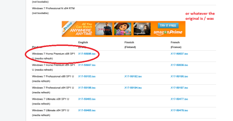

Hello and welcome aria mate try this http://www.sevenforums.com/tutorials/219487-clean-reinstall-factory-oem-windows-7-a.html#post1839164
Read it thoroughly first and then make sure you pick the original version of Windows and don't do what some daft people do think they can put on Pro or Ultimate when the original version is Home.
See my pic for picking the right version I use a disk but a stick is ok for the ISO.
PS Meant to mention this will also get rid of all the Acer bloatware but do backup any dtat if you can.

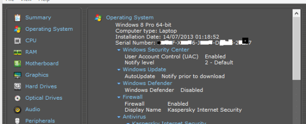

Sorry late repy aria mate is the problem machine a prebuilt or a home build? If it is a prebuilt -store machine when they mad it they would have stuck the OEM (or retail) sticker on the bottom that has the version activation code on it
However if it has been built by the owner or someone will like me a lot of people omit to add that sticker. So you are stuck trying to find out what that is one method that might work is to run Speccy Speccy - Download download from piriform and if you open out Operating system it should give yu the original version and activation code se my pic of my readout for my laptop.
Give this a try if you can and swat it was original - tied to that motherboard.
