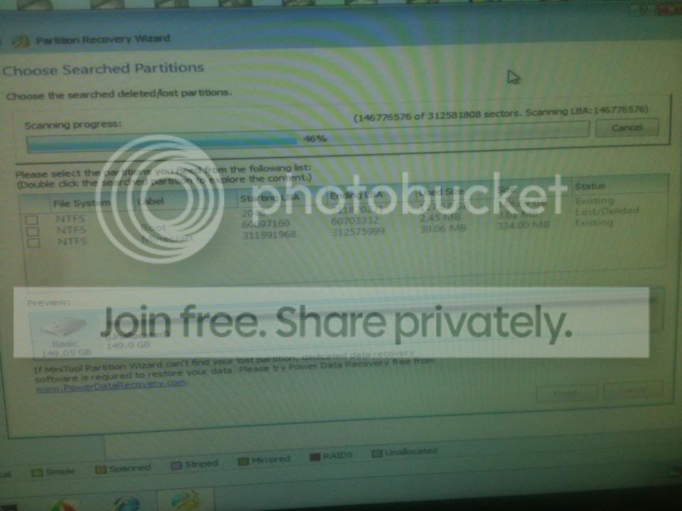

I was splitting the partition so I would have two 60gb partitions. But when I'm doing the partition recovery it detected a partition called boot and it says it's lost/deleted. What should I do?
Be patient. First tell me exactly what you did. You resized the 120GB partion to 60GB, so make it smaller? then you made a new empty partition sized 60GB?

Don't recover partion in Partition Wizard now!!
Go to the main screen. How many partitions do you see? Size, type.... etc. tell me or better... make a camshot and post

Ok heres the picture, as you can see one is labeled nothing with used size:117.67gb Size:148.69 and says existing,which is my main hardrive. one is labled boot with Used size: 2.45 Size:3.01mb and says lost/deleted. then the last one says minecraft used size:39.06mb size: 334.00 mb and says existing.
