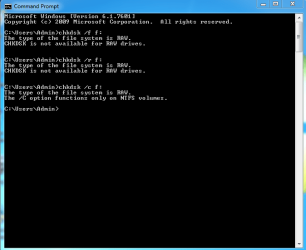

ok quick update..
i went ahead and opened it because it was out of waaranty anyway... followed a tutorial from youtube to see how to open it.
i bought a dock t see if it would work with that and same problem. just the light flashes but will not come up on my computer or disk management.
i followed another solution on youtube via the commandprompt. and it said chkdsk not available for RAW drives.
does this mean the hdd has become RAW?
