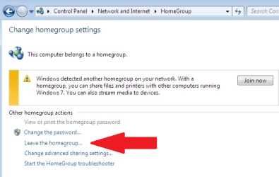

Since the Vista and XP computers cannot use Windows 7's HomeGroup, you will have to add 7 to your Workgroup. In Windows 7 you might as well remove any traces of HomeGroup and disable IPV6: Start here by leaving and removing HomeGroup

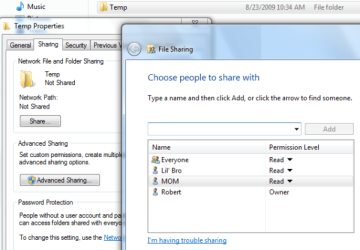

To share files between computers you will have to select or create folders, open their properties and "share" with "Everyone".
