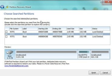

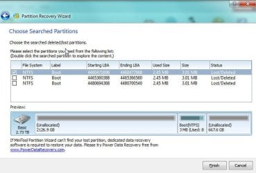

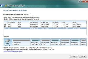

Hello! The scan is done now, but unfortunately it does not look that good!?
First image shows PW without any partrition selected, second image with all selected.
Do you think there is a chance to reactivate the lost 3GB partition?
Thank you very much! Martin

Yes, it doesn't look good. It appears that the disk had undergone three format attempts giving rise to three boots. Only one of them may represent your last known state.(And you must be knowing better how your HDD looked like in its last working state.)
Now do not select all. Select one at a time and look at the disk map.
Does any one show your full disk without any unallocated space? That should be the right one.
I would suggest you post the three screenshots with only one boot selected in the order shown. Let me see all the three pictures before deciding what should be done.

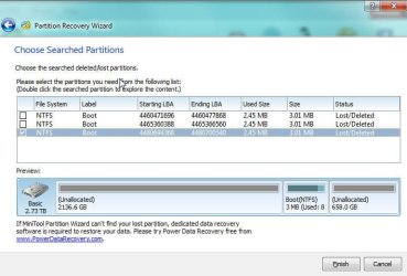

Hello and thanks. The three partitions found all span only a small part of the disk. Here are the three screens:

OK, Partition Recovery Wizard is not going to work here and rewrite the correct partition table.
You may try to recover data either using PhotoRec or TestDisk.
If you are going to use Testdisk, exercise caution not to give any write command. You will use it only to copy the found files to another external drive of sufficient capacity which should be plugged in before you run TestDisk.
PhotoRec is much safer in that you can't give any write command at all :).
( It still beats me why the Boot partition and another small partition shows up at the end.I have always been advocating for quite sometime, given that we don't yet know how well the conventional partitioning/formatting software can deal with GPT drives, anyone having a GPT drive should save the first few sectors where the Protective MBR, the GPT header and the GPT Table resides. Then when any mishap like this occurs merely by restoring the saved sectors one could easily resurrect the drive without going through the timeconsuming data recovery procedures like this..)

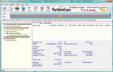

Attached is the screen shot of partition image how it sees the disk.
Thank you very much again for your help, I really appreciate it. Thanks!

External 3TB drives are usually NTFS formatted and recognized at~2.7TB through special driver even by older OS's this suggests MBR.To make it work as internal for the os you have to have it as GPT. So best to ask manufacturer first about methods to recover. Perhaps one of the wizards converting MBR to GPT but i have no experience.
Where Guru shows partition table raw it should be MBR
and both Sector size and Physical sector size 4K. I'm not 100%sure though.
