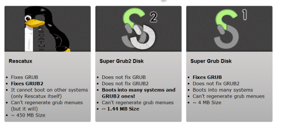

Super grub is a good utility - Apparently you can boot into windows partitions with it but I am yet to try it.
Another way:
Boot off Ubuntu live cd: Terminal
sudo apt-get install lilo
sudo lilo -M /dev/sda mbr
Now attempt to boot into your windows partition
