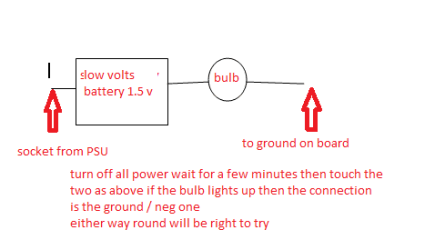

The polarity well the fan will either spin or not as long as it is not a direct pos to neg connection then it will get hot - test with a multimeter before you fire up. If you haven't got one there are cheap ones available and just ordinary continuity testers plus get a battery and a small light bulb and wire the bulb to the battery touch one end to the socket one to the plug if the bulb lights up then it is a dead short if you connect to the supply.
