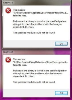

I ran Malwarebytes and it found several DLL as malware and it deleted them. But the downside is, now REGSVR32 is complaining the DLL's are MISSING.
But at the first boot, I get 2 errors from REGSVR32 that it can not find "C:/User/xxx/AppData/Local/IQsoft/vvccipww.d.............. and that is all Windows listed in the window so I dont know the TOTAL name.
I see a DLL can be "unregistered" by using REGSVR32.EXE but since Windows 7 will not give me the entire name, and Malwarebytes has deleted the DLL, I dont how how.
Anyone know I can it get rid of these TWO error messages at every Boot?
error windows attached.
PS: Tried CCLEANER as suggested from 2014 post but did not work.

The files pointed in the dialogs are obviously the virus files that Malwarebytes deleted, but it's evident that something else is still there and your computer is still infected.
RegSvr32 doesn't popups out of nowhere, something is calling it and asking to register the now-missing libraries. If it happens at startup, look up at the startup location to find out where the virus is hidden. You may try another antivirus too.
The full file name doesn't matters at all. Something else is still trying to run the virus file, and the file being missing triggers that error.
Of course, since your computer has a confirmed infection and has been already breached, the only safe choice is a clean install.

REGSVR32 THINKS "IQSOFTxxxxx" it needed but can not find it for Startup.
No! Regsvr32 doesn't thinks at all, it just respond to being invoked explictly.
"Something" is calling it to attempt to run a virus file at startup. It's pretty obvious that there is a startup entry where a virus is still there, and that is calling regsvr32. You're still infected. You don't know exactly where a virus could be hidding, thus a clean install is the only safe action at this point.
other posts says to "unregisted" the DLL "IQSOFTxxxx.DLL" FROM REGSVR32 by using REGSVR32.exe. but that is impossible as the entire name is not giving my MS.
Don't do that! For one, the file no longer exists (the antivirus deleted it), but most important, you know it's a virus, so you don't want to run it, no matter what. It was deleted for good, so forget about it. The full name doesn't matters either (but to satisfy your curiosity, you can search the logs on the antivirus)
I understood the C;/User/xxxx/IQsoft yyyyyyyy IS the offending file REGSVR32 is trying to register and is missing because Malwarebytes did delete for GOOD reason.
Not this time. The deleted file was a virus and it was deleted, that's good. But the thing triggering the message is something else that is still on your computer. A deleted file can't simply do anything at all :p

Resolution of Error messages from REGSVC32.exe
I ran several Virus Scanners and it did not stop the STARTUP of the Regsvc32 error notification.
I then ran a REGEDT and did a FIND on IQSoft and in the Register, I did find IN the :
HKEY_CURRENT_USER/Software/Microsoft/Windows/CurrentVersion/Run/
the TWO software apps that were listed in the REGSVC32 Error messages at startup.
I deleted them in the:
and I assume the "RUN" implies they are to be "RUN" startup.
After the next BOOT, they no longer came up.
Closed, Thanks
