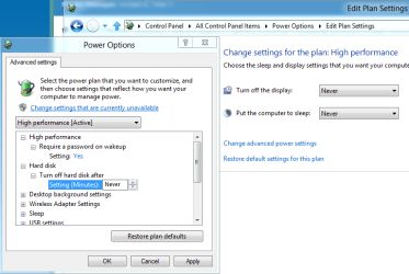

This is usually because the hard drives on the slower machines are in sleep mode and it takes awhile for them to spool up. It's set to 20 minutes by default.
You can turn off that feature by going into Power Options>Advanced Settings, picture below shows more. Hit the Apply button after changing to "Never".

Well, the thing is that all of my other computers are set to the default power settings as well and they do not experience this. One more thing, the computers in question here are using SSDs that are very fast. I don't think this is the problem because it's pretty isolated. What else can you think of?

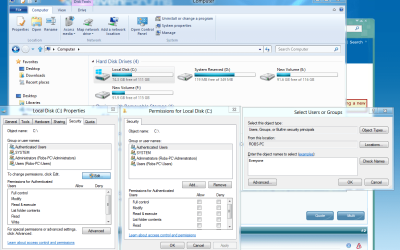

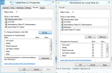

You will need to set those permission's on the "Security tab" as I mentioned earlier. Directions for this below. This should help with the password problem although I'm still not sure why it keeps asking for one.
To share the entire drive:
Open My Computer -> right click Local Disk D or which ever drive letter your drive is using -> select Properties -> select Security tab -> click Edit button -> click Add button -> enter the name of the User you want to set Security permissions (it is the same user name you've set the sharing permissions for, ex. Everyone will set the read permissions to every user. Put check marks in the boxes for full access and control -> click OK hit apply-> select the desired permissions -> click OK -> wait while permissions are set -> and your Done.
You will also need to use the Advanced sharing tab Sharing>Advanced put a check in the box to share the drive, then click on the permissions tab and "add Everyone" then use the check boxes to allow Everyone full access. Hit the apply button on both windows.
