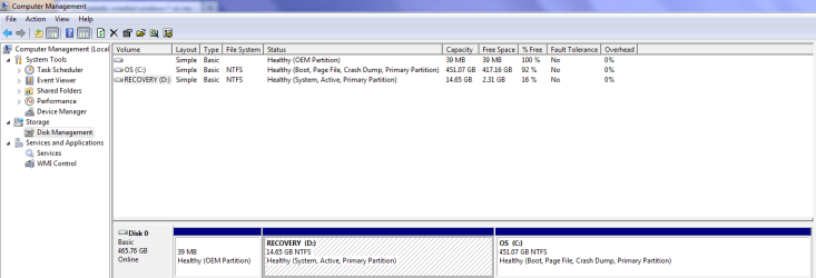

Perhaps post a screenie of the contenst of your "D" partition.
Screenie of disk mgmt window would help, too.

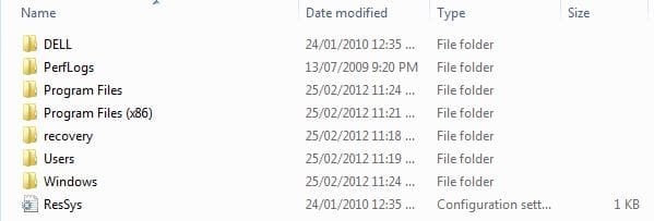

Thanks, here are the images of my D partition contents and disk Mgmt
windows 7 64 bit
windows 7 64 bit
Dell partition is system.
That is fine.
TO access Dell recovery options you need to add the dell bootable wim to boot menu.
It maybe called winpe.wim or similar.
It will be on D somewhere - look in the folder named Dell - and all it's sub folders and post screenie.

Just did this. The only 2 files in the Dell folder are:
catalog.ini (It is a configuration setting file)
and Factory.wim (Is this the file you are talking about, and how do you use it to access the recovery options?).
windows 7 64 bit
windows 7 64 bit
If factory.wim is large - 3gb or so - then that is the installation wim.
You are looking for the preinstallation wim - it is probably under 200mb.
It is possible you may have overwritten it - look in the folder recovery\{longnumber} as well.
