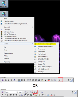

Don't worry about debugging it yourself. Just copy the dmp(s) to the desktop, and select all of them. Right-click on one>send to>new compressed folder.
Then upload it to this site.
