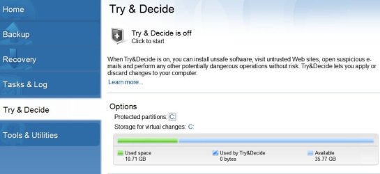

Okay, i'll give it a try, now
Be right back
LE : Here i have 2 options to modify C
Do i have to change them, both, to D ? Would be better ?
Thanks

Misconceptions
Let the software assign the disk letter. None of the data goes to your "real" disks until your choose save. The virtual disk will operate just as if you were on your boot disk. (The virtual disk is in ram not on a physical disk)
Example: Try and Decide working and I install fubar software. The installation asks me where to install. I pick D:\programs\fubar and everything progresses. I try out fubar and i decide to keep the changes. So I do a save when I close Try and Decide. Fubar will be written to D: disk as I designated. My registry will be updated and the software shows up as if I had never heard of Try and Decide. But lets say I didn't like the new software. So I do a discard when I close Try and Decide. AtI dismounts the virtual disk and does not save any changes (The changes are in ram). My disks are now in the same state they were before I tried out the new software.
I understand perfect :) But i don't want ( in case i wanna keep Fubar ) installed on D
" The installation asks me where to install. I pick D:\programs\fubar and everything progresses. I try out fubar and i decide to keep the changes. So I do a save when I close Try and Decide. Fubar will be written to D: disk as I designated "

I see what maybe causing some confusion. Contrary to what I said about ram T&D might use some space temporarily on your boot disk. But I stress it is temporary.

Install Location
Your the boss install to Q:\ if you like. Just pick an existing real location.
I'll try it right now.
Be right back.
Okay.
I changed C on Try and Decide, picked up D.
After that i installed Mozilla Firefox 8 Nightly Alpha 1 on D:\ Try and Decide \ Mozilla test
Reboot - discard changes
Mozilla Firefox 8 Nightly Alpha 1 is not there anymore :) So far, so good.
If i wanted to save changes, Mozilla Firefox 8 Nightly Alpha 1 would be installed on D, which is not recomended.
If i would choice to install Mozilla Firefox 8 Nightly Alpha 1 on C:\Mozilla test, after Reboot - discard changes, Mozilla Firefox 8 Nightly Alpha 1 would be still on C, which is NOT good :)

The only reason I recommended keeping your temporary space on another drive other than your C drive, was simply to prevent any slowdowns.
As mentioned, once try and Decide is activated, any change what-so-ever will be stored in the virtual space assigned to it.
No changes are actually made to your installation.
Things may run a bit slower while its active, since its keeping track of/and writting all new DATA to the virtual Enviroment.
This may not be that noticeable with a SSD, but it will speed the process of discarding or applying changes.

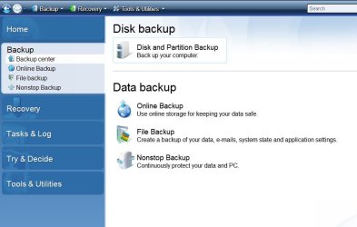

I would just doing a Full disc image of the SSD, and restoring it in that same manner, rather than by partition. Although that would work fine as well, a full image is easiest IMHO.
Can you tell me how to do that, please ?
What option do you choice, like in the picture ?
Thank you.
