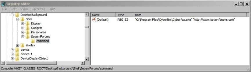

Here's how to add a shortcut to SevenForums in your desktop right click context menu.
Open Registry Editor:
Start> Run then type
regedit
Press ENTER
Then navigate to:
HKEY_CLASSES_ROOT\DesktopBackground\Shell
Create a new KEY (Right click Shell then choose create new key)
Rename the new KEY to Seven Forums
Right click on the Seven Forums KEY and create a new SUBKEY giving it the name command
Select command and in the right pane modify the default value by double clicking (Default) and enter the Value:
"C:\Program Files\Cyberfox\Cyberfox.exe" "http://www.sevenforums.com"
replacing the "C:\Program Files\Cyberfox\Cyberfox.exe" part of the above with the full path to your browser's executable.
You can also change the display position to a choice of Top, Middle or Bottom by highlighting the Seven Forums KEY and in the right pane right click to create a new String Value with the Value name Position and Value data Top (or Middle or Bottom).
Use the same method to add an icon.
Highlight the Seven Forums KEY and in the right pane right click to create a new String Value with the Value Name Icon and for Value Data enter the full path to your desired icon.
Example: D:\icons\Favicons\sf.ico
Close the Registry Editor.
