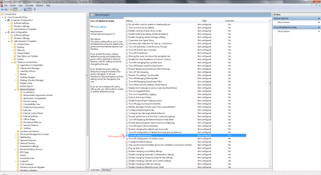

There might be a easier way to enable TAB browsing, but one way to check whether it has been changed is use Microsoft Management Console:
Click Start Orb, type mcc in the search box, and open Microsoft Management Console. Browse to the area shown in tha image. and see if TAB browsing has been configured not to show.

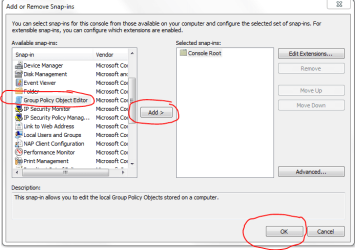

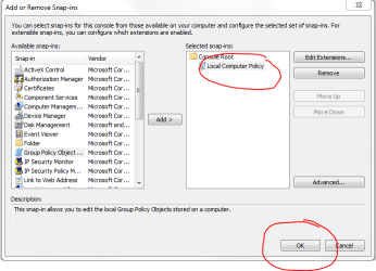

Hold on. You need to do the following to get that tree view (I assume you hadn't done that):
1. Open MMC
2. Click File > Add/Remove Snap-In
3. Select Group Policy Object Editor (see Image)
4. Click Finish on Pop-Up panel (see Image)
5. Highlight Localy Group Policy, click OK (see Image)
6. Now you can browse to get the extended tree as per my first post image.
